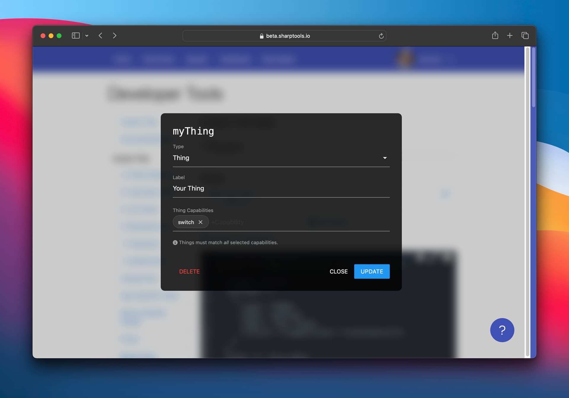

# Things
You can define a SharpTools Thing as a setting within your Custom Tile. If you define which capabilities the device must have, the list of things presented to the user when configuring the tile setting will be filtered to devices which match that capability set. This is helpful for ensuring that the device selected by the user will have the attributes and commands you expect for use in your custom code.
You can interact with the Thing using the stio library to access attribute values, subscribe to attribute updates, and send device commands.
Capability Filter Details
Filters Match ALL
Please note that if you include more than one capability filter, only devices which match all of the filters are displayed to the user.
For example, if you include both motionSensor and temperatureSensor capabilities, the user must have a device which implements both of those capabilities. If you want access to a separate motion device and separate temperature device, you'll want to define each as their own setting.

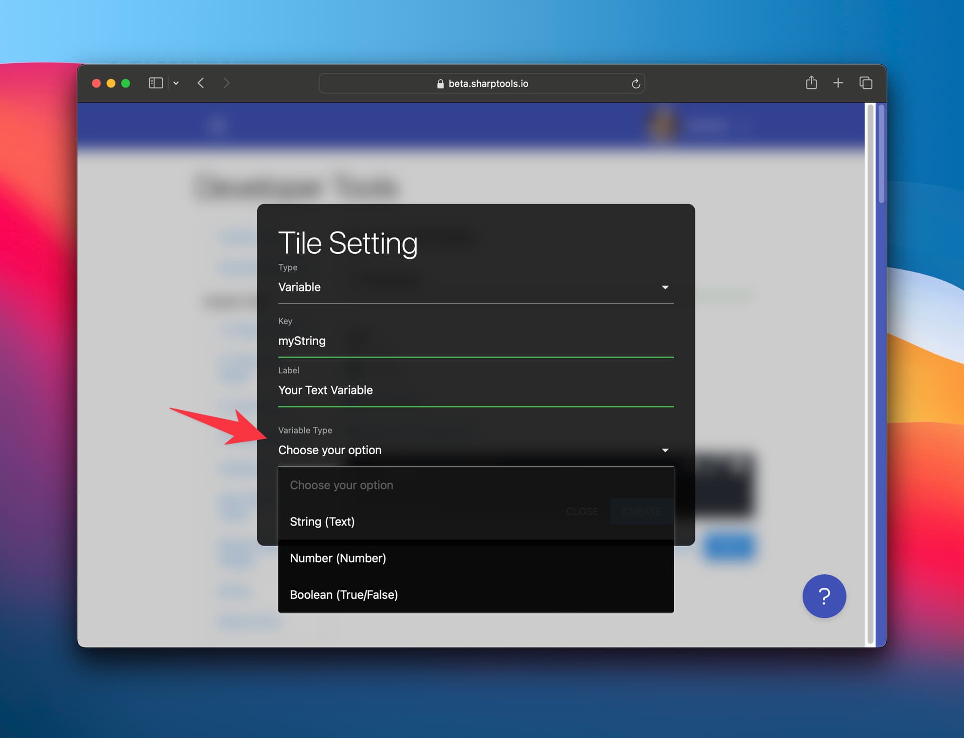

# Variables
You can define a SharpTools Variable as a setting within your Custom Tile. You must select the specific type of variable to restrict the variable selection to.
You can interact with the Variable using the stio library to access the variable value, subscribe to variable updates, and set/update the attribute value.
