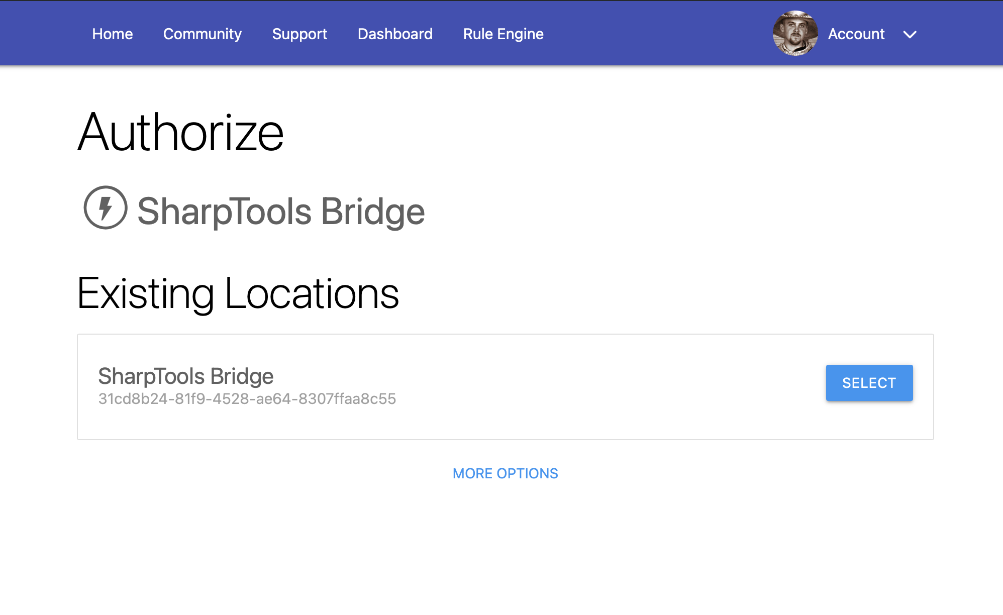

Not seeing an expected location?
When authorizing SharpTools Bridge for the first time, you'll need to create a new 'Location' for the bridge to sync to. If you previously authorized a bridge to SharpTools, those existing locations may be displayed for you to select.
If you aren't seeing an expected existing Bridge location, tap the 'More Options' link at the bottom.

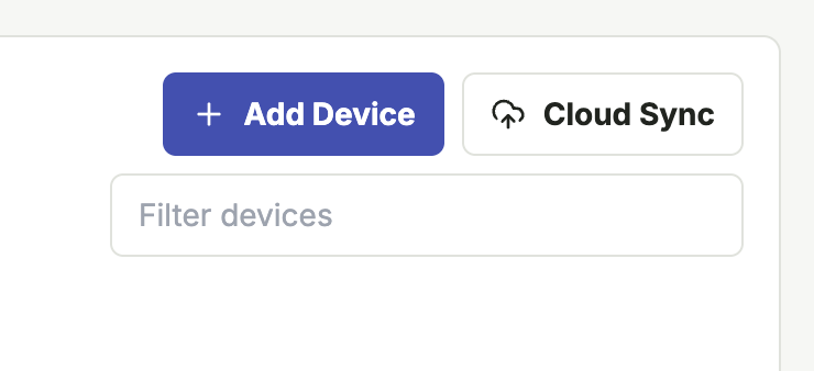

- Open Devices in the Bridge UI.
- Tap the Cloud Sync button
- Check the boxes next to the devices you would like synced
- Tap the Sync Now button to complete the synchronization
