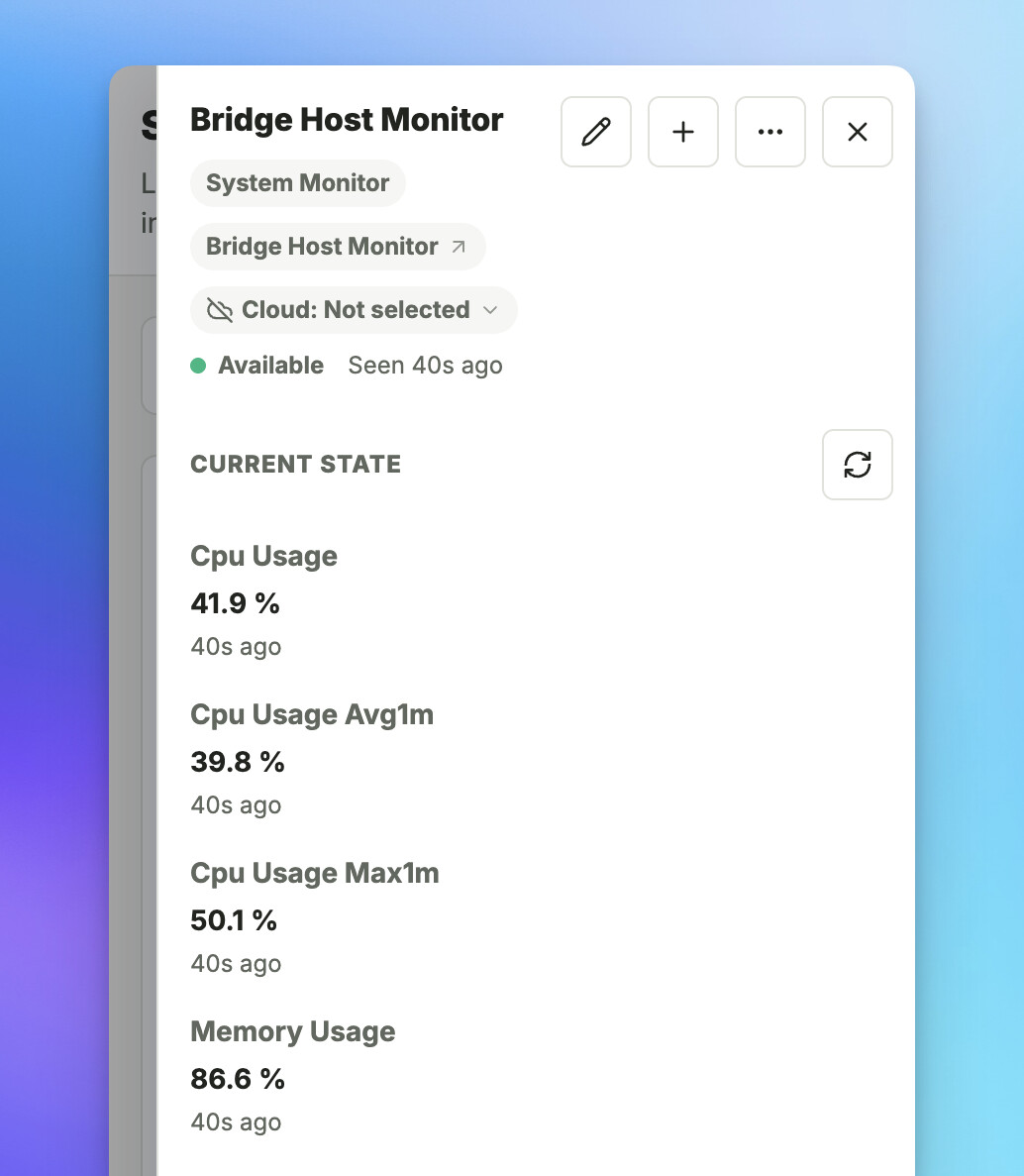

Reported Metrics
The monitor reports:
- Current CPU usage, one-minute average CPU usage, and one-minute peak CPU usage.
- Memory usage, used memory, and available memory.
- Bridge process CPU usage and resident memory usage.
- Storage usage and available storage for the filesystem containing Bridge data.
- Bridge process uptime.
- Metric scope, such as
native,container,virtual, orunknown.
Storage and memory values use readable units such as MB, GB, or TB. Uptime automatically uses seconds, minutes, hours, or days as appropriate.
